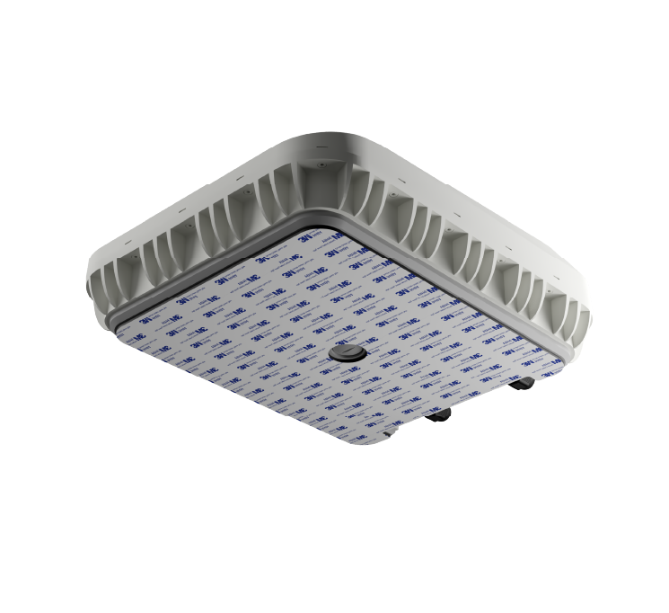

Mount it your way with a variety of installation options ideal for vehicles, rooftops, poles, or even custom rack systems.
Adhesive Surface Mount
Magnetic Mount
Deck Mount
Pole Mount
Surface Mount
Note: The deck and magentic mount kits is NOT included in the package.
